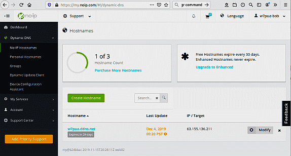

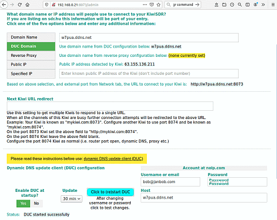

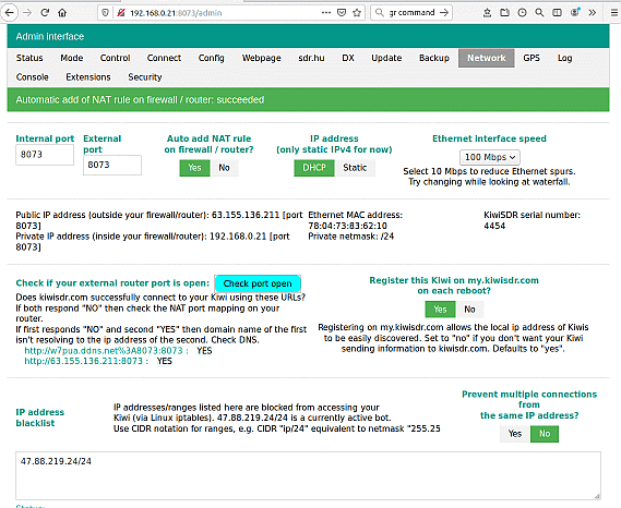

I am setting up my KiwiSDR. I'm not network smart, but I believe I am trying to use dynamic IP for my local network (DHCP), Auto add NAT rule and noip.com to translate from w7pua.ddns.net:8073. "Check Port Open" with kiwisdr.com shows Yes Yes. But when I try to open a receiver I get a time out and no connection. To help, here are the three relevant screens:

What setting did I mess up? After I get this to work, I will post the proper settings to help someone else with this. Thanks, Bob

From inside the network it may not work from http://w7pua.ddns.net:8073 as the router is stopping you looping back into the public interface from the private.
Fair bit of noise on the antenna at the moment but I could connect.
Also, in your DUC config take the ":8073" out of the host field. Looks like it doesn't hurt anything but it makes a few other things look weird (e.g. first "check open port" URL). I should change my code to automatically filter that out like I do in a few other places.
