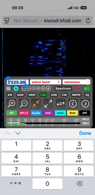

    New issue. There is no longer a decimal point to use for frequency entry. That button was replaced with one for +*# . Currently frequency can only be entered to the lowest kilohertz. See picture
    Thanks for hearing me out and explaining what is going on.
    Jim
  • What iPhone model, iOS version and browser? I only have an old iPhone 10 running iOS 16, but my keypad has the "." not "+*#".
    We went through this debacle of Apple changing the HTML-to-keypad mappings some time ago. I swear, if they've changed it again...
