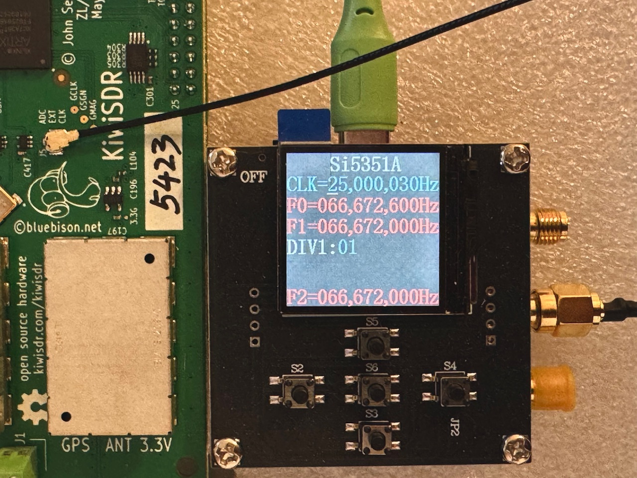

66.666 MHz TCXO for KiwiSDR. Jamming/spoofing GNSS.
Soldered ipex1 to kiwisdr. Connected synthesizer with VCXO 0.5 ppm (from Aliexpress). Works well. I heated the synthesizer very much - the frequency is stable. SMA connectors on the synthesizer are not very good quality. It is better to solder directly. The synthesizer was calibrated using a 9996 kHz time signal station.
Thanks for the advice. I've seen these synths before but thought they were crap.
