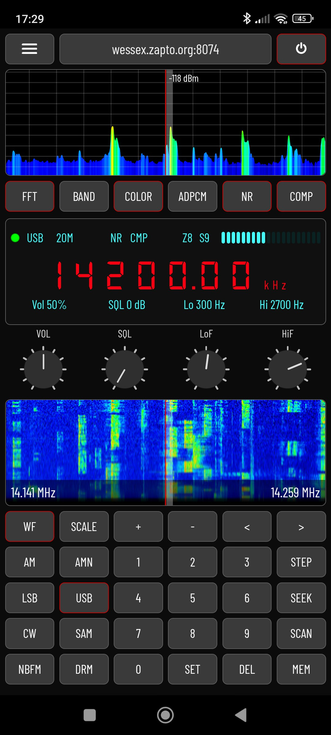

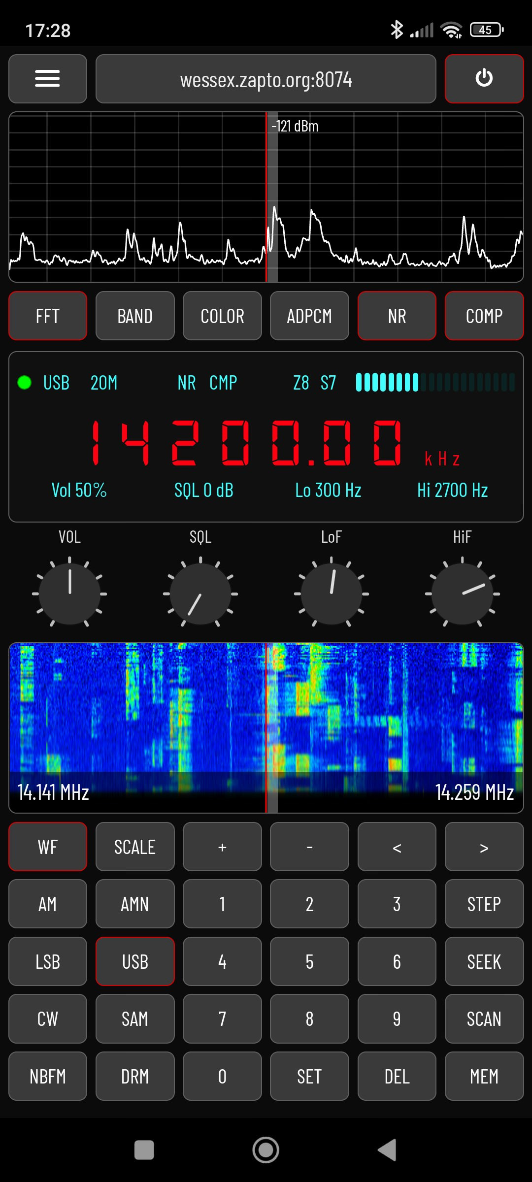

    FYI: I am working on version 2 which I will release shortly (I am testing right now). This is a major change in the interface: I listened to users feedback and you will have both a waterfall and spectrum display (with gridlines and dBm meter) on the screen, and the band buttons will be dropdown, step mode, separate station seek button, ...
    Check here soon. ;-)

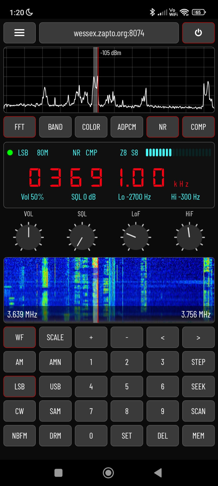

    barneyuk I changed the knob behavior so knob sensitivity is now adaptive based on both the finger travel available in the swipe direction and the remaining value range in that direction.
    Swiping from the knob start position all the way to the screen edge (top or bottom) now maps exactly to the remaining value in that direction.
    i.e. swipe from current position to the top → reach max.
    swipe from current position to the bottom → reach min.
    That makes the control naturally more sensitive in the middle (because the remaining range to either extreme is smaller) and less sensitive near the edges (because you have to travel the whole remaining range to reach the extreme).
    Small disadvantage: the resolution for the band lo/hi knobs is a bit less (that is the tradeoff).
    Download QiwiQ 1.41.15 at: https://bit.ly/3I49LfD
    Let me know if that feels more natural.
