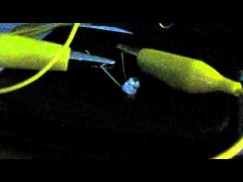

I have an endfed wire, 20m long and 6m above ground.
Could read a newspaper with that LED flashing.
