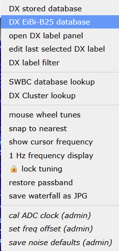

    Second, I don't understand why you'd want to do this. We already have an integrated EiBi database. Yes, it's A25. I've been waiting for B25 to be released. I don't think this csv file is the official B25 release as eibispace.de only shows a 27 Sept update to A25 as being current.
    The integrated EiBi database has a special filtering control panel that you don't get by uploading EiBi entries into the stored database. You lose that functionality which is important given that there are so many overlapping labels (more than 10 thousand).

    I see as of this morning Eike has made an official B25 release on eibispace.de. So I will get that into the next software release.
