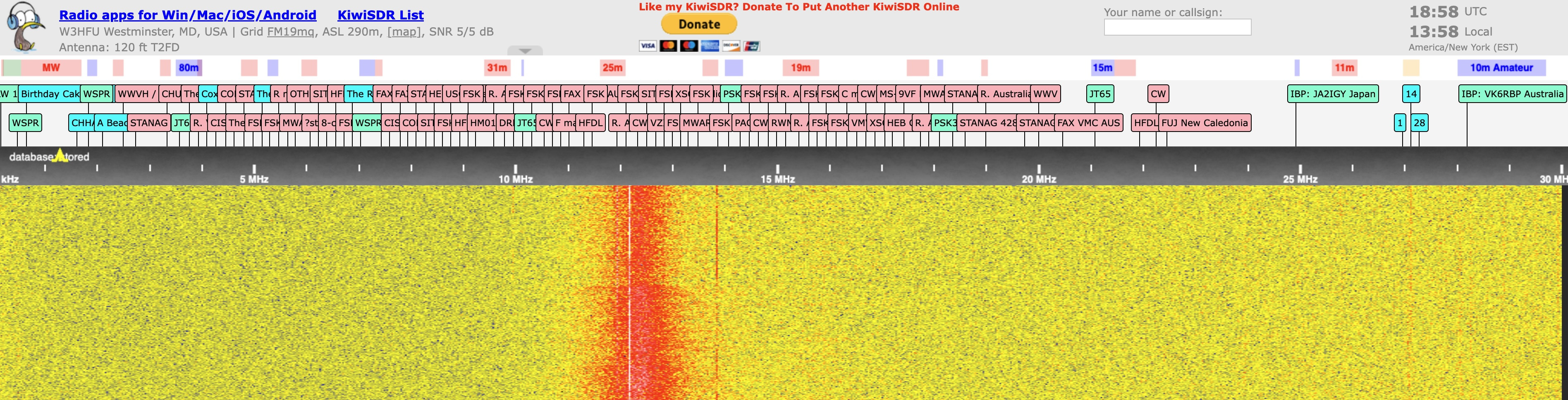

    And if I go to a receiver tab in the browser, it tries to work. It comes up, there's a waterfall, but it's updating very slowly, with just a distorted buzzing sound for audio, and the waterfall doesn't "look right". I've attached a screenshot (I hope)
