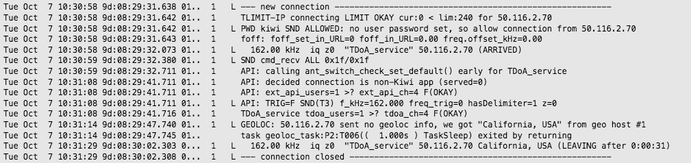

    Hi all,
    Yes the TDOA_service is legitimate, it is the task that collect the samples when you use the TDOA extension (what a surprise ! ;-) ) to locate a station. When it goes well it stays 30s (or the other choices in the extension) as can be seen below in my /var/log/messages file.

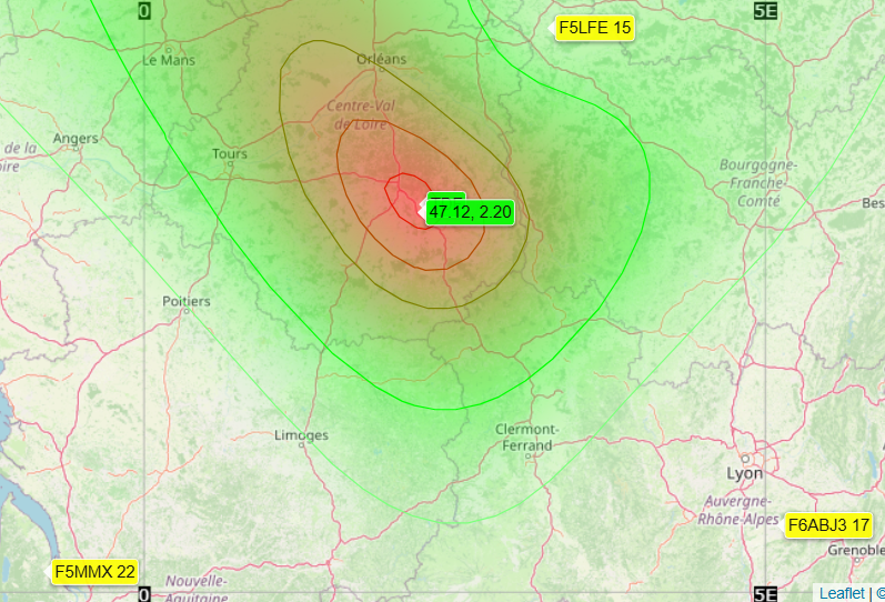

  • Hi, @F5LFE, Francis,
    I did a test TDOA around 12:30 loc using your station, on Allouis 162kHZ. Very good result !
    (see your log, you should see something vey similar to my image above)
    Your station is among the best in F, would be very sad if we can't TDOA. ;-)
    73, Thierry
  • @F5AFY,
    This time everything went well following your result and my log is OK.
    My intention is not to stop the TDOA service, I was wondering why it was denied sometimes.
    May be when all channels are busy with regular users ?
    See your connection into my log :
    Tnx for your nice words about my kiwi ;o))
    73 Francis.
