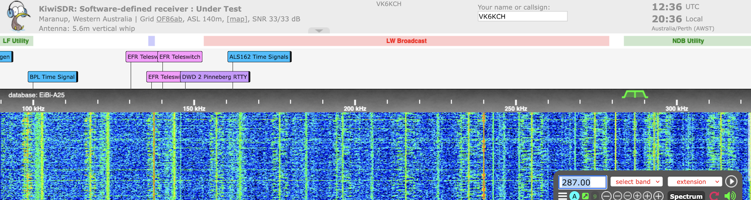

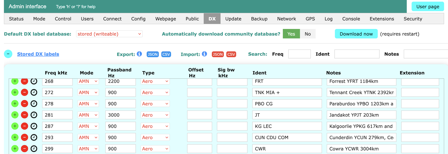

  • I'm not sure which version this change occurred in, but there seems to be a little bug whereby user defined DX labels aren't displaying above the waterfall. I've included a screenshot to show that the database entries are still in the unit.
    Is there a setting I've missed, or is this a software bug?

  • It looks like you are displaying the "DX EiBi A-25 database" there, not the stored database which you are editing. Right-click the band bars above the labels area to select the labels set you want.
    VK6KCH
    edited September 19
    Also, the backslash '\' key toggles which label database is being displayed. The name of which is shown in small white lettering in the top left corner of the frequency scale. Type 'h' to see a list of all shortcus keys.

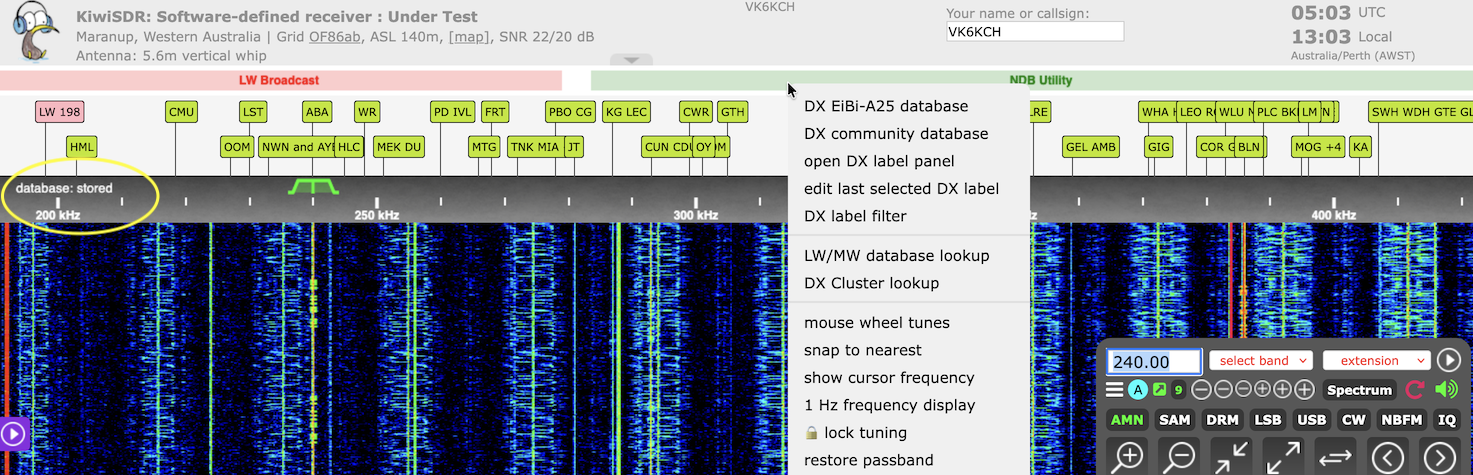

  • Thanks for the two pieces of very useful help. So, it was of course, very easy in the end!
    Right clicking on the band bar (eg, on "NDB Utility") gave me the drop down menu, and I could then select the database that I wanted (which is then displayed on the left hand side, as highlighted in yellow in the attached image.
    Thanks!
