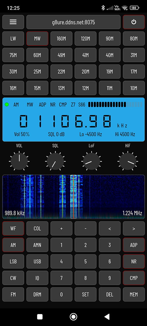

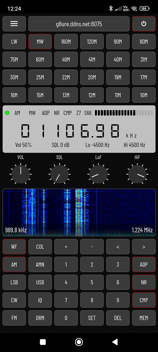

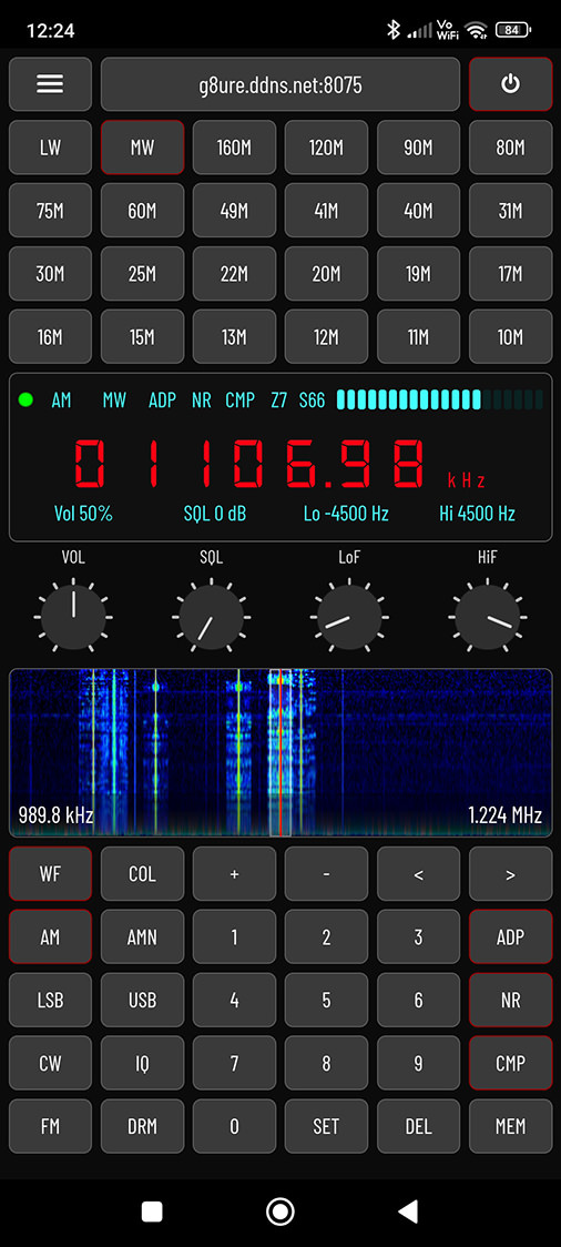

  • edited September 3
    There are different LCD color themes:
