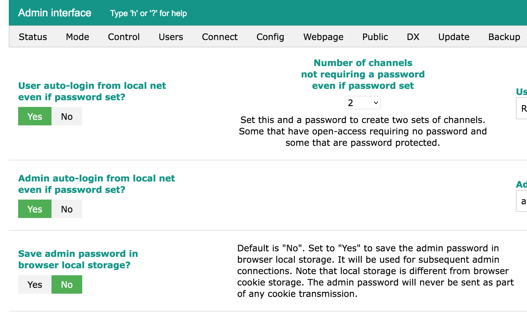

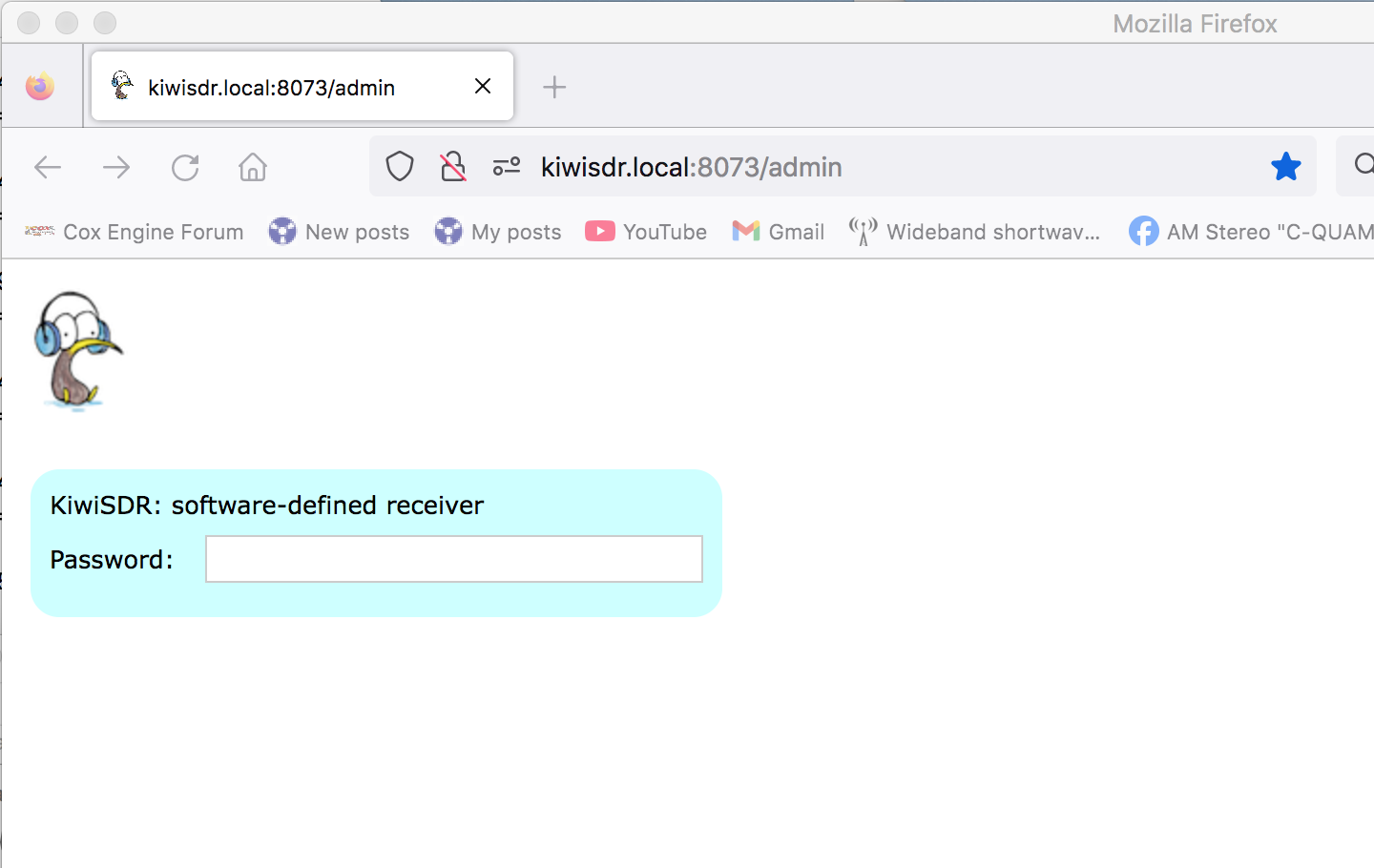

While connecting to my Kiwi using http://kiwisdr.local:8073, it appears I'm taking up one of the non-password protected channels, getting an inactivity timer and requiring a password to edit DX labels. While accessing the Admin interface via http://kiwisdr.local:8073/admin, I am met with a password prompt.

If you remove the admin password and try connecting using kiwisdr.local:8073/admin I'll bet it says something like:
No admin password set. Can only connect from same local network as Kiwi.
Client ip = [fe80:0:0:0:c61:36bd:206a:6886]
Which means kiwisdr.local is getting translated to an IPv6 link-local address (the
fe80
part) in a mixed IPv4/IPv6 network. And the Kiwi's local network bypass scheme currently only works for IPv4 local addresses. But I could probably fix that.And... I think I see what's wrong. IPv6 link-local address are not being recognized as valid local addresses due to a very simple bug. I wonder why I never saw this before?
