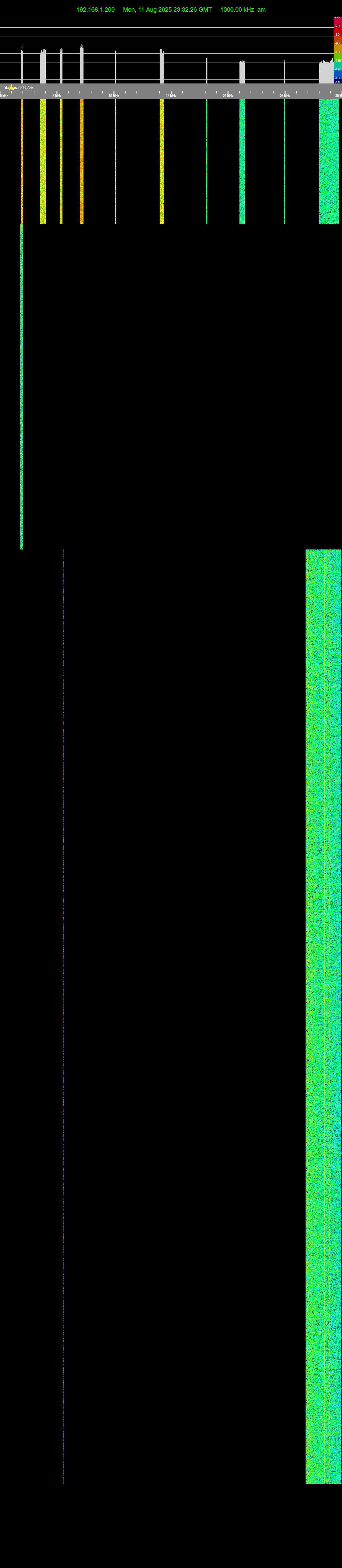

OK how have I locked only Ham Band Spectrum & Reception
Im stumped how I got this done

    Probably in the admin "DX" tab you used the red buttons import JSON or import CSV on the downloaded files mentioned in the document.

    And just to clarify: I noticed your waterfall capture shows you have the EiBi label database selected. And this masked stuff you set on the admin DX tab only applies to the "stored" database, since that's the only one that is writable.
    But think about it: If you really don't want people listening outside the ham bands then you don't want them to side-step that restriction by simply selecting the EiBi or community databases. So masked frequencies are applied regardless of the label database selected.
