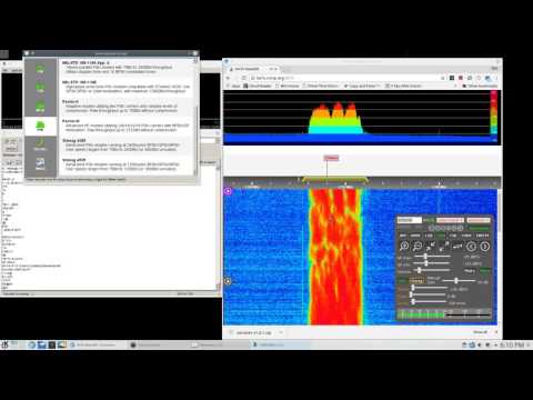

This is just a video showing Sorcerer 1.0.1 running on Linux under the WINE API and using Pulse Audio to connect from KiwiSDR to Sorcerer.
Ron KA7U

    And a screen shot showing 100% confidence and 0 errors, so in this case the stanag signal seems to be properly tuned.
    https://forum.kiwisdr.com/uploads/Uploader/45/e4e59e64e1b67eb60bdaed3042351c.png
