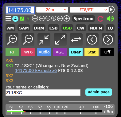

@jgreentn - There is a rabbit hole you are probably looking down right now. Uplifting that dipole would likely help, however, what is your noise floor like? i.e, what's the S Meter showing when not "tuned in" to any signals?
example:
So for me, on 20mtrs, the noise floor is just above S3 and I live in a built up urban area. Where my Xiegu G90 connected to an EFHW gets an S5-6 noise floor.
The difference being my KiwiSDR is using a magnetic loop
I've tried different LNAs on passive antenna, and as Martin said, you just raise the noise floor and lose even more weak signals.
