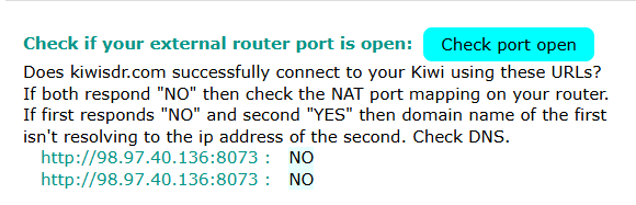

On the kiwi admin page using the "Public" tab, I am informed ===> rx.kiwisdr.com registration: successful
yet, my kiwi does not show up on the map.

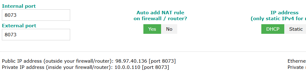

At the kiwi "Network" tab ===>
and

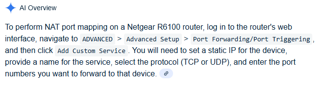

A search provided this ===>
I have no understanding of what will happen to ALL of the other users of this router trying to get their email/etc
if I mess around with the router's settings.

You have a Kiwi-1 stuck with very, very old software (v1.665). You will not be listed unless you can get updated to a more recent version.
Please email support@kiwisdr.com. We need to get you on the proxy service so I can connect and get your Kiwi updated to the latest software. You won't have to do anything with your router, which won't help anyway due to Starlink.
