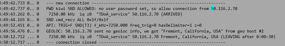

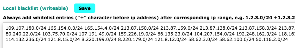

I recorded 50.116.2.0/24 into my local blacklist few days ago since the 50.116.2.70 IP address was considered as a wrong connection.
Tonight my log is stil saying that this IP tryes to connect despate the local blacklist.
I am may be wrong in my understanding so I am joining snapshots about this.
Usually a blacklisted IP does not appear anymore in my log.

  • 50.116.2.70 is the kiwisdr.com server, which can't be blacklisted.
  • OK
    Sorry for my lack of knowledge about it.

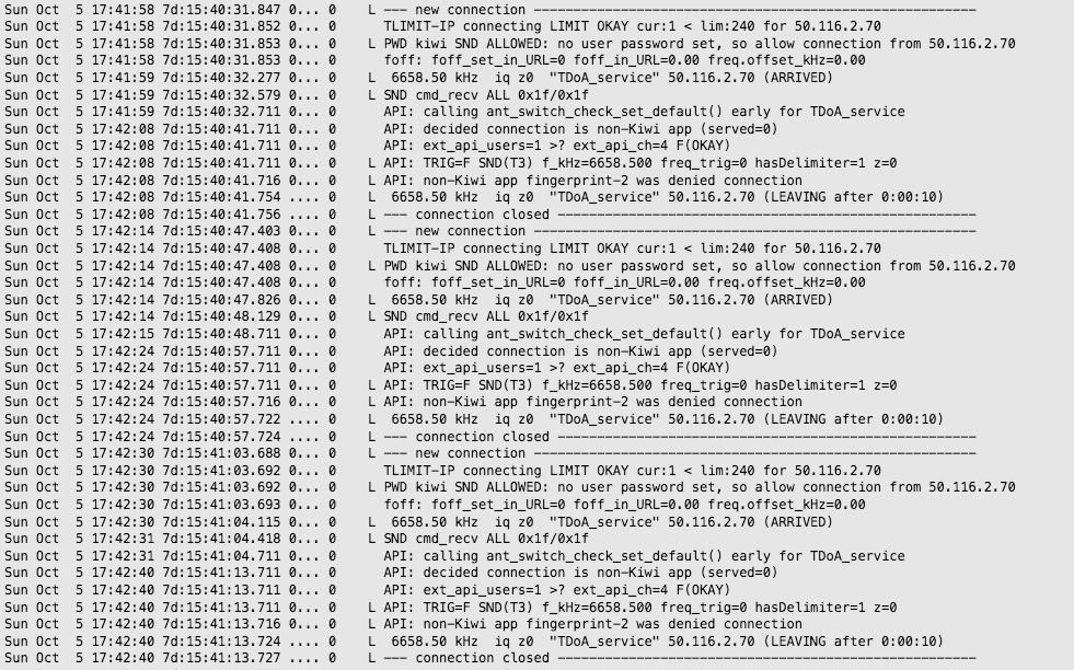

    But in this case why my system denies this connection ? (see my log)
  • I'm not sure...
    What's your setting in "Number of simultaneous channels available for connection by non-Kiwi apps" on the "Control" page?
  • 4 all of them in fact
  • edited 7:18PM
    Hi all,
    Yes the TDOA_service is legitimate, it is the task that collect the samples when you use the TDOA extension (what a surprise ! ;-) ) to locate a station. When it goes well it stays 30s (or the other choices in the extension) as can be seen below in my /var/log/messages file.
    The non-Kiwi app filter has been set by John a while ago to get rid of "ip trolls", but it's amazing that kiwisdr.com is considered as some of them ! May be a side effect of adding its IP to the blacklist ?

  • There is a setting on the admin / extensions / TDoA tab to prevent your Kiwi from accepting TDoA connections if that's what you want.
