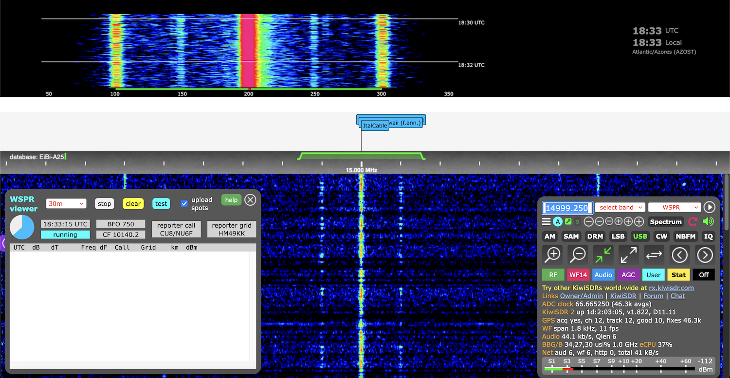

One better way to assess frequency cal / drift than simply using zoom level 14 is to use the WSPR extension since it has an FFT display that has very good resolution. In the screenshot below I have set it to run on 30m. But tuned to a dial frequency of 14999.25 so that the time station carrier is in the middle of the display (200 Hz offset). Notice that it looks pretty good. Maybe just a tiny bit low. What's important is how stable that carrier is in the WSPR display over time with the GPS "good" sat count being a relatively large value (say larger than 4).

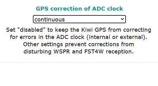

Of course this option in page admin/config (bottom right) has to be in "continuous", right ?
(in the case it's been changed)
He mentioned in his email to me (but not in the post above) that it was set in continuous mode.
