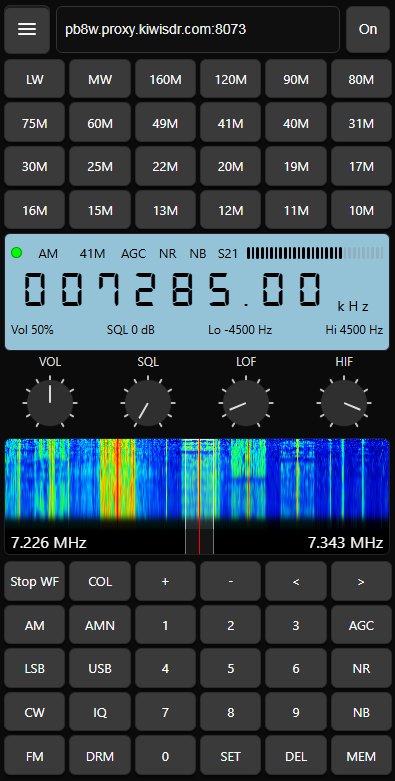

Version 18 is now ready. Many features now work, like signal meter, compression, noise reduction, noise blanker, spend 1 day on reworking the audio decoder, now cracking and chopping solved.but lots of work to do...

My SDR Radio is almost functional.
But I still cannot create a SQUELCH function.
I need help for this protocol.
