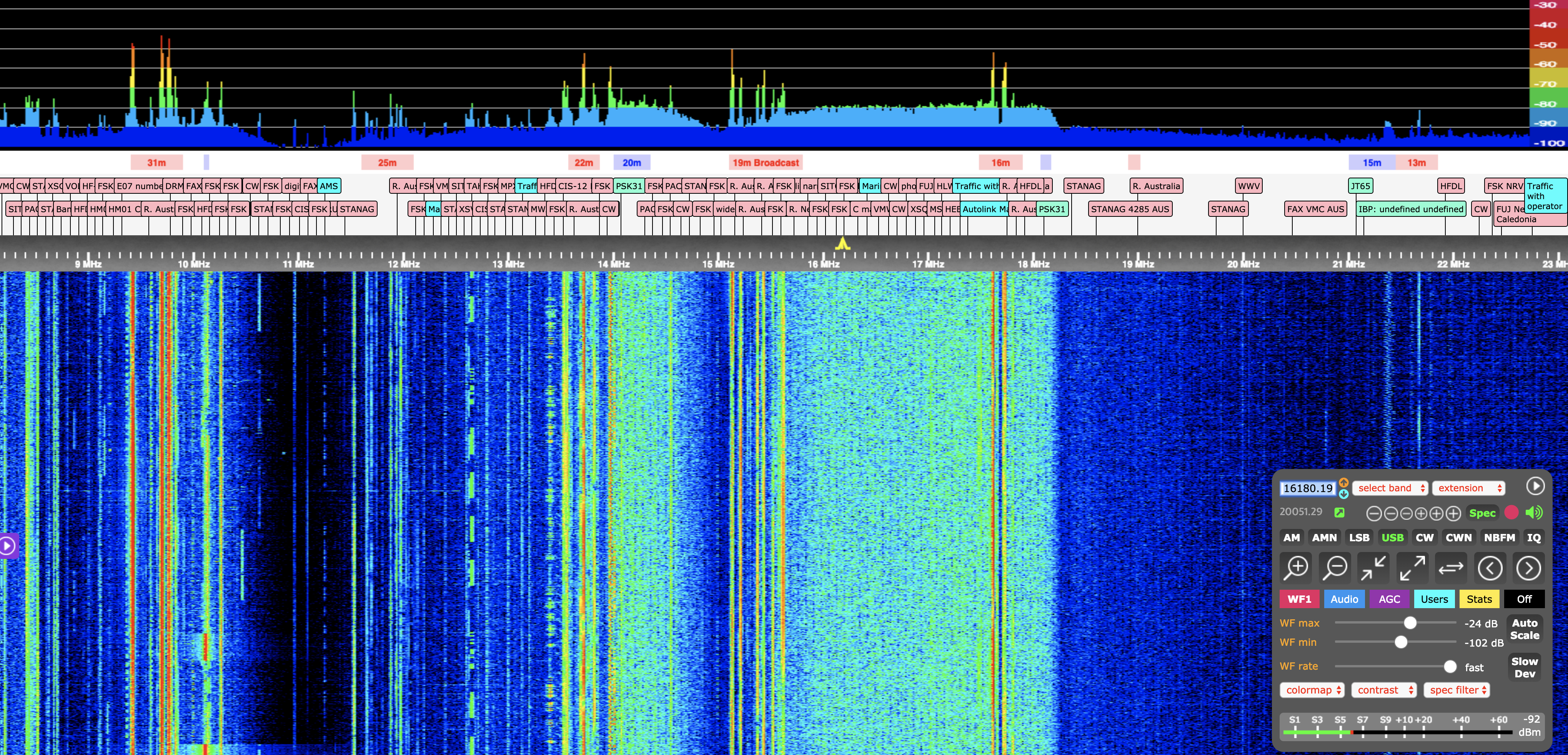

Dear All,
I tried with different antennas (same locations) but nothing. There are some thresholds of noise as in picture on 3,5MHZ, 5MHz and 14MHz. Without the antenna (I tried, hi!) there is a uniform white noise.
Any suggestions? Is it the same also for your stations?

  • There are at least two problems that I can see. First, you have terrible switch-mode power supply noise in the LF band. The harmonics are very wide at LF and so will be even wider if they are present at HF which can make them appear more like broadband noise. Look at the screenshot below of 0 - 450 kHz. Almost all of that is SMPS noise. And half way through the waterfall capture these huge wide signals appeared at 65 and 98 kHz. You really need to track down and eliminate these sources of noise.
    The second screenshot has a suspicious looking abrupt left edge on the noise pedestal at 5.24 MHz. That is quite possibly interference from VDSL Internet service.

  • Yes, 5.2-8.5 MHz and 14.1-17.7 MHz are downstream bands of VDSL. Upsteam bands in between are also partially visible.
    I had the same problem and the authorities found a broken overhead line. After they fixed it, the noise was gone.

    NEWS: I went to my neighbor, with whom I have good relations. I asked him to turn off the devices and power supplies he had turned on one by one. Well ... the 68kHz problem is solved: it was a switching power supply (which I changed at my expense) of the cordless.
    The problem with the VSDL remains, which I really don't know how to solve it (especially for 14MHz noise).
