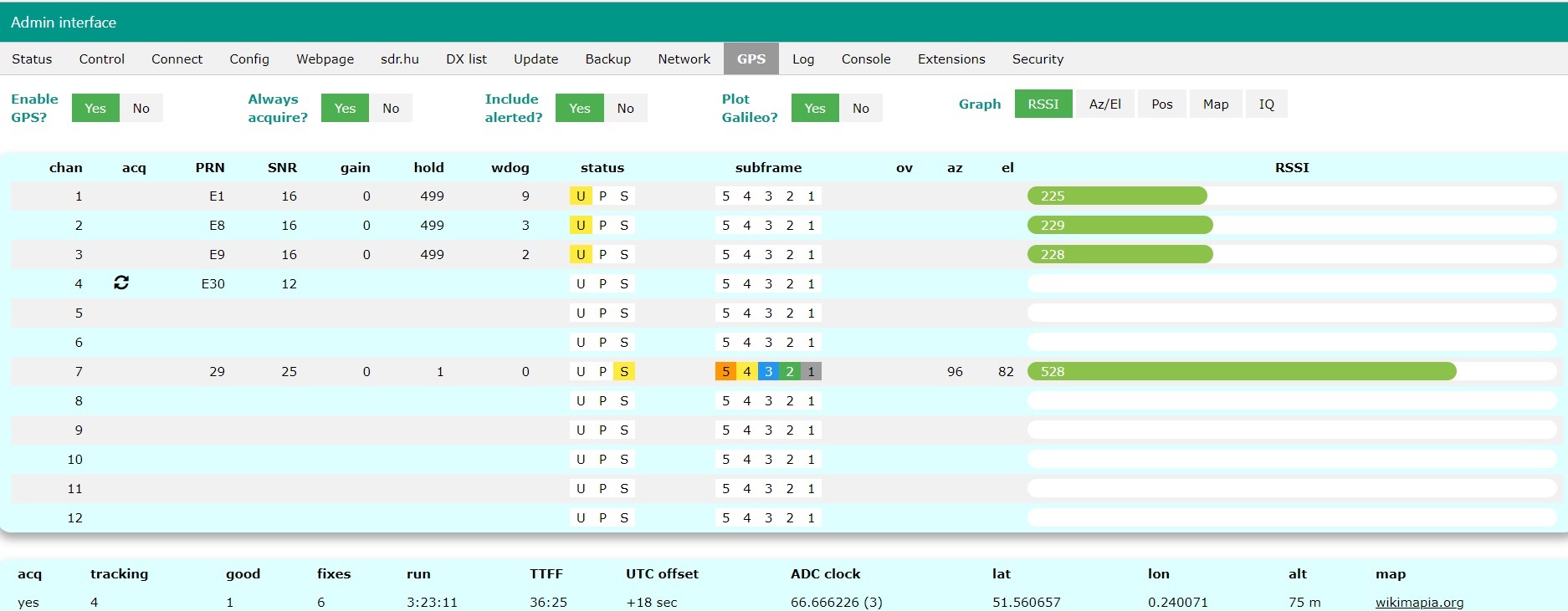

enclosed image shows a typical screen, tracking

In your image PRN29 having an RSSI of 528 is marginal. Those Galileo E1/8/9 trackings are false because the SNR was only 16 at acquisition. An RSSI in the 200s means the tracking loop is unlocked (and the "U" status symbol agrees).

The image shows the best I have had for a while, what does the PLL "kick" signify?
Your new image above looks fine actually. RSSI in the 1200-1500s for Galileo is pretty normal. The GPS RSSIs are a little low. What concerns me is the shadow map. It's only been a 6 hour run, but it's clear you only see sats above 45 deg elevation. Worse, because you're at 51 deg latitude the GPS polar "hole" is coming into effect and that is limiting what you get above the W-E line. So your actual sky view is smaller than I thought.
But having only 212 fixes over a 6 hour period is terrible. Another issue is that when you limit your sky view to one area like this you have high "dilution of precision" (GDOP, https://en.wikipedia.org/wiki/Dilution_of_precision_(navigation)). This will cause the time/positions to be less precise and they may be so far off that they get filtered out.
