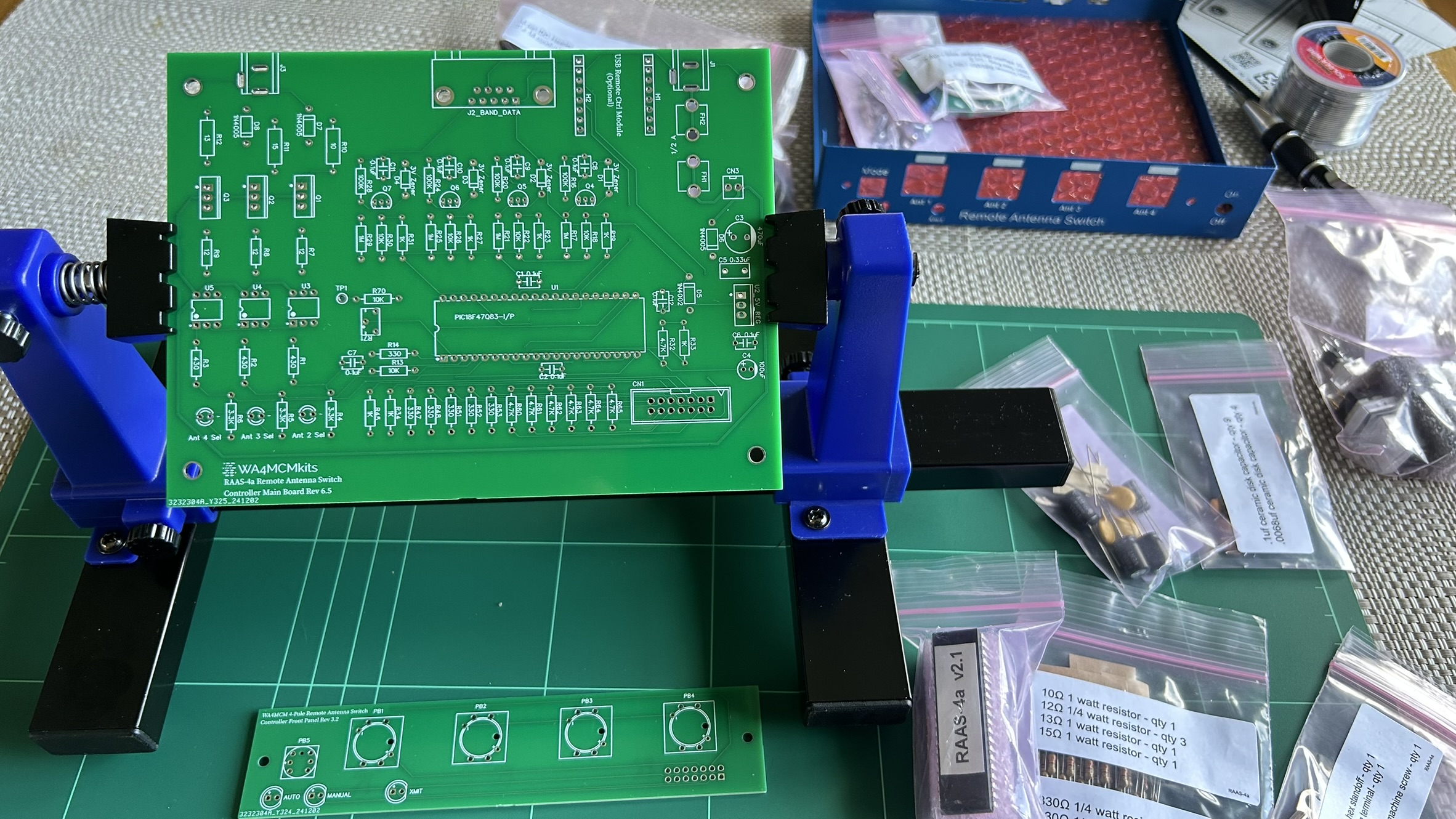

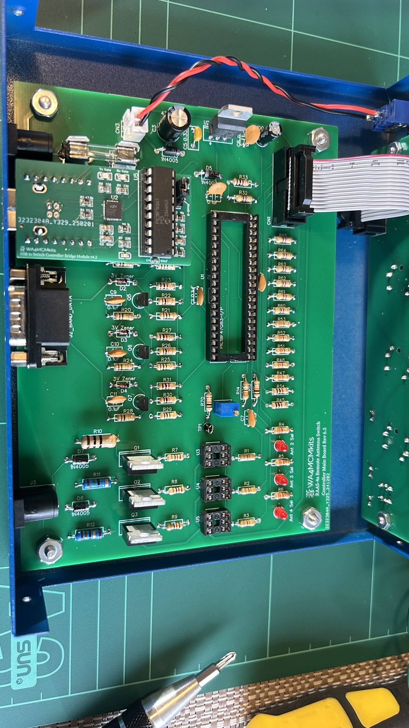

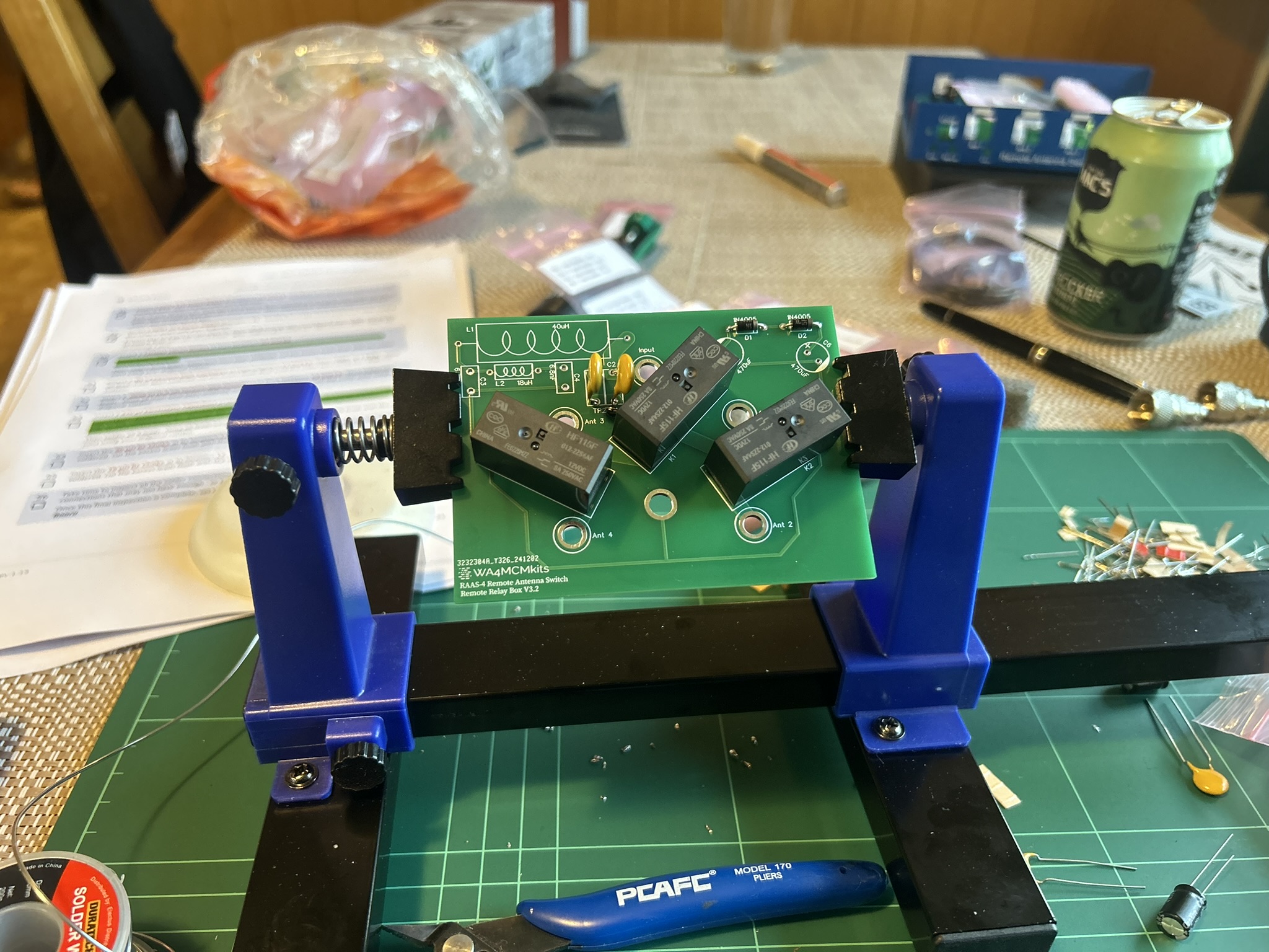

Well this arrived today
Looks like my long weekend will be soldering this kit! :-)

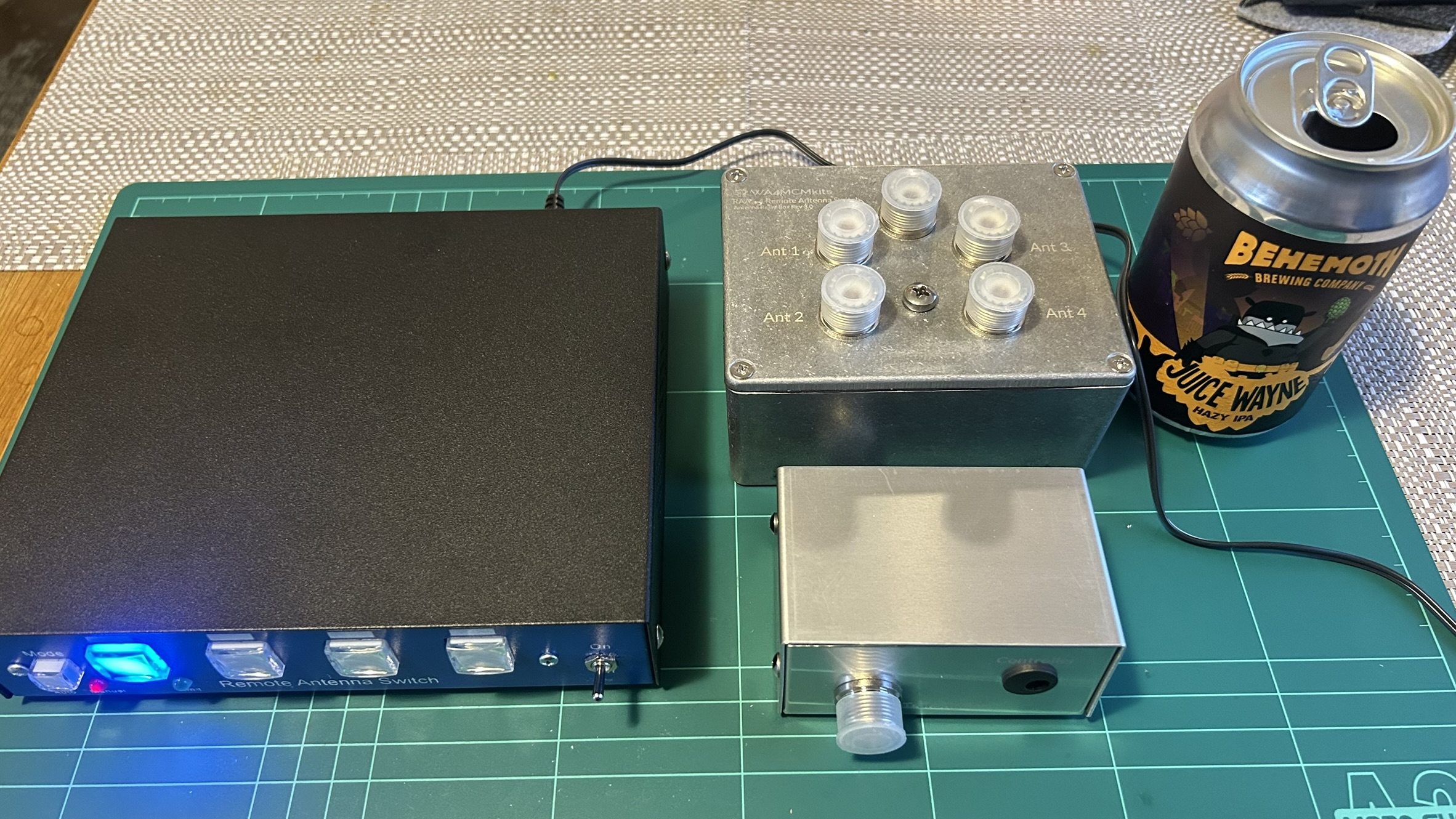

I was quite chuffed with how mine turned out.
