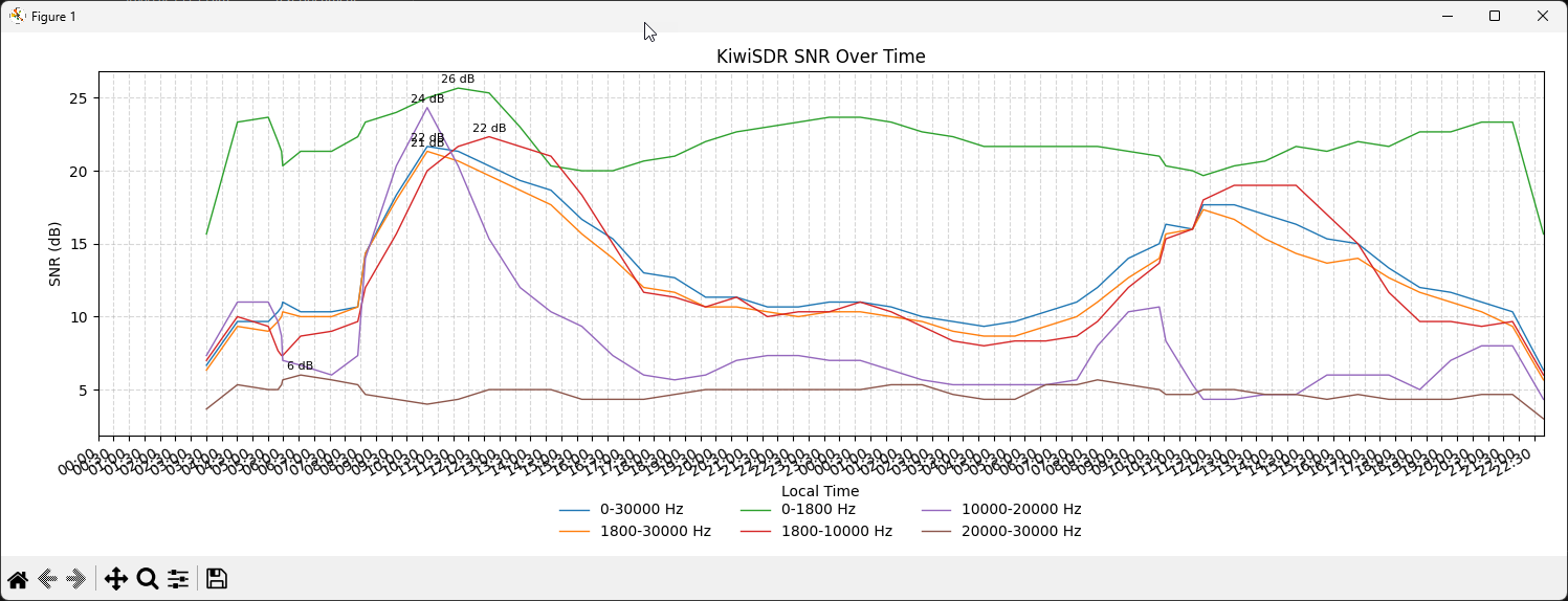

    An SNR graph into the admin page? :-D
    I have been using blackcats SNR logger, however it always clears the graph when the kiwi restart for any reason - like an update etc.
    So I tried a little Python and some AI help to write this monstrosity! :-D
    It uses a poller to collect the SNR records from the Kiwi and write them to a file. Another script then parses that to this graph using matplot libraries. It's very buggy, and not 100% what I wanted, but it's close. You can see I also have it noting the highest levels of signal on the graph
  • Yes, it's a pity that the BlackCat logger looses information when the KiWi reboots. I've also found this to be a disadvantage if you wish to keep a long term record.
    Your Python code seems to be more useful.
    I wonder if a daily (24 hour) max / min value, for each frequency range, which could then be used to calculate a difference between the two, would provide the "figure of merit" I mentioned.?
  • Well if anyone knows python, they are welcome to make this good :-)

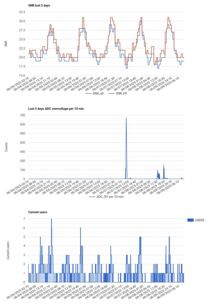

    I've been using SNR level logging, adc_ov, and the number of users for a long time. The charts are available as a web page, and it is located on the Kiwi server in the config folder as simple html file. The code was written a long time ago without using AI )) . That's why it looks ridiculous, but it works great. You can use it as a blank for your code.
