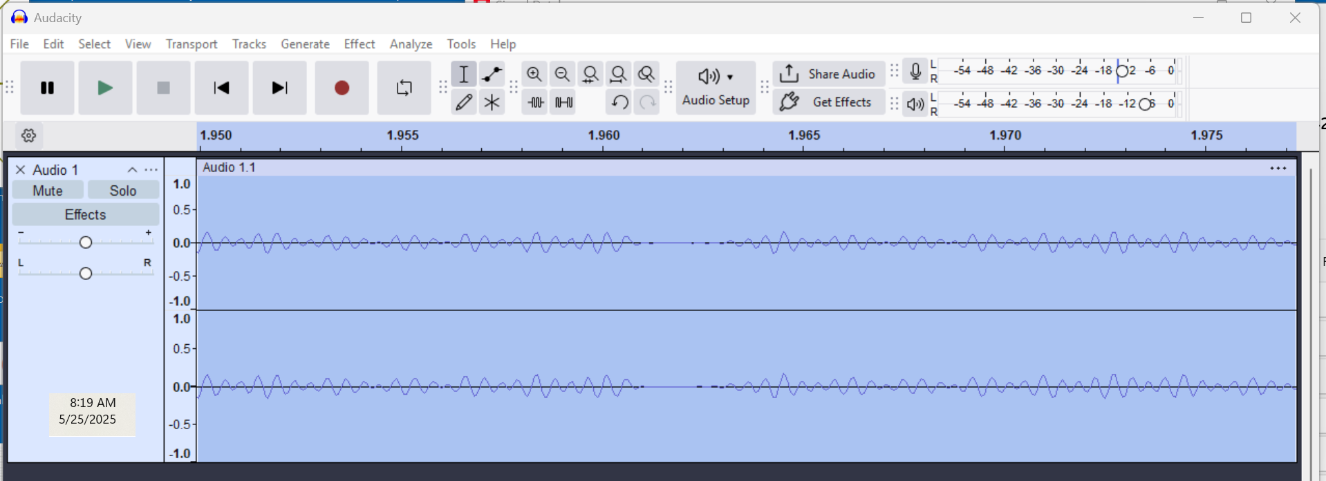

I've been seeing gaps in the audio sample stream. The gaps seem to be on the order of 30 samples. [Edit: on the order of 128 samples at 48 ksps.] They happen randomly. They seem to happen on average every 8 seconds. But there could be three gaps in a second or no gaps in 30 seconds.
If you are listening to voice or music you'll hardly notice them. To make them more noticeable tune to an AM station with little sideband content. Such as WWV. Then select USB mode and tune below the signal so that the carrier is about in the middle of the passband. You'll hear the strong tone but with occasional glitches. You might even see them in the waterfall. [Edit: It's not visible in the waterfall.]
I've tried this on two different computers. I see it happen on every receiver/server.

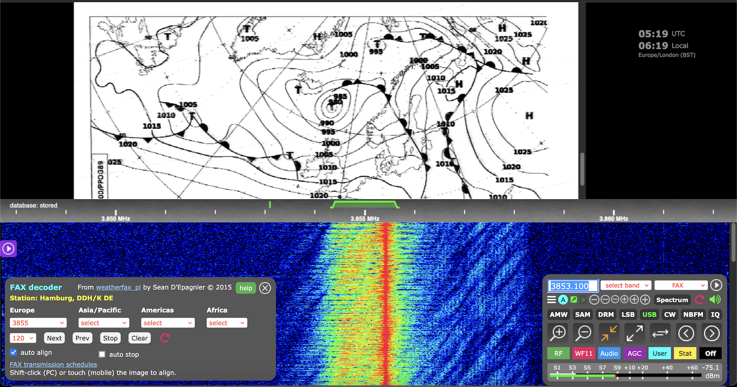

    The most sensitive test of dropped samples is to run the FAX extension. The slightest dropped sample will cause the image to become progressively more shifted (i.e. lines looking broken) as the image rendering proceeds. I tried this just now on several Kiwi running the most recent software version and all seemed well. An example image is below. All those lines should not have any offsets or breaks. The 400 pixel tall FAX viewport at 120 LPM represents 3.33 min of reception. So no dropped samples over that time period.

    The dropouts seem to be about 2 ms in length. Timewise they seem to be randomly distributed with an average of about 1 dropout per 8 seconds. I see the same using two different computers and with both Chrome and Edge browsers. Attached are pictures of a couple Audacity captures. The kiwisdr screen shot shows the settings used for the Audacity shot with the purer constant tone.
    I don't think you would see it in a fax. A dropout would be about 0.4% the width of one line. And they would happen on average every 16th line. And the fax decoder is continuously adjusting its sync, isn't it.

    Slightly off the topic - look how clean your weather fax is! 😮
    edited May 25
    About the FAX extension: It does not use the per-line sync signal. It relies on the precise known sample rate for timing (even though that rate is not a fixed number due to how the Kiwi frequency calibration works -- but that's another story). This is also why there is a manual horizontal framing adjustment. There is a "page stop" detector based on received tones.

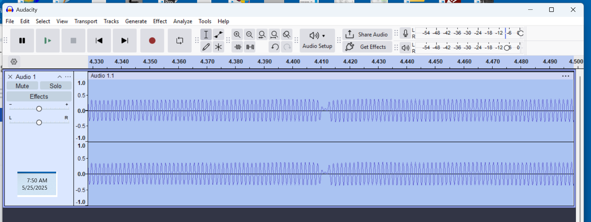

    I use Audacity and set the recording input as Stereo Mix (Realtek (R) Audio). I can hear the gaps even when Audacity is not running.

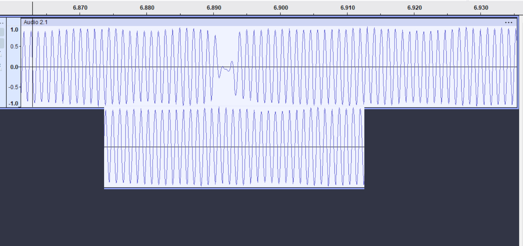

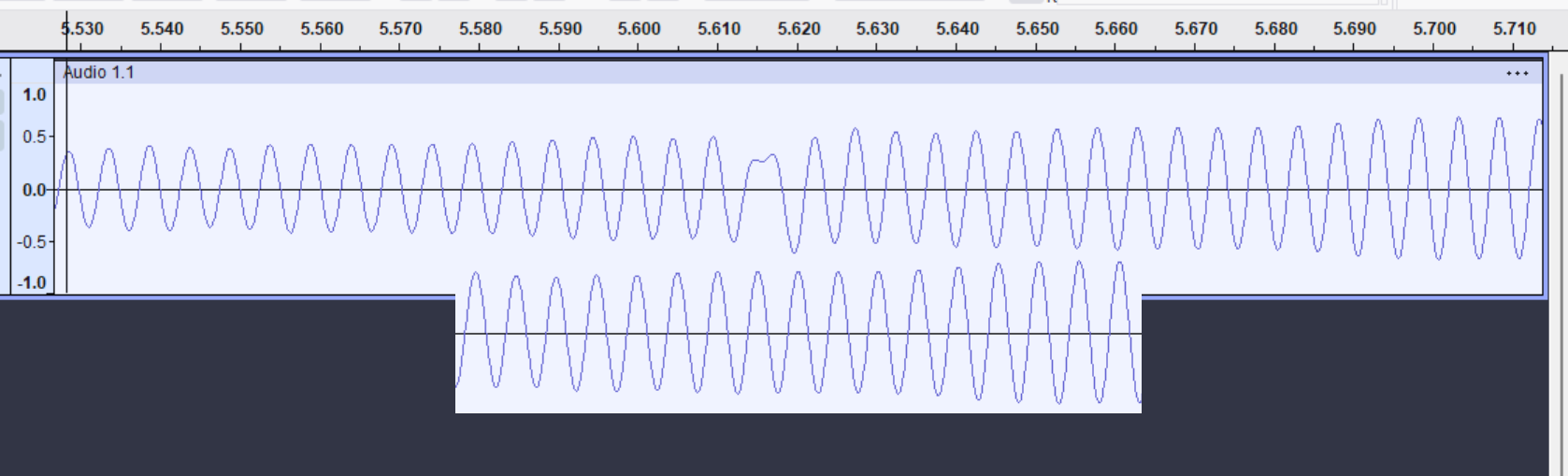

    I've done some more measurements too. Every event is the same length. They are about 2.6 ms. The samples after the event are shifted by 2.6 ms. At certain frequencies that results in a 180 degree phase shift. Images attached. I get those waveforms by tuning below the carrier of WWV in USB mode and narrowing the passband (as best I can) to just include the carrier. If I tune 400 Hz below the carrier then I get a 400 Hz tone.
    The offset frequencies that give 180 phase shift are those where an odd half multiple of the period is equal to the gap.  f = (2n + 1) / (2 * 2.6ms) I.e. 192, 577, 961, 1346 Hz,...

    I'm using Audacity to record what is going out to the speakers ("Stereo Mix"). But Audacity is not a factor because I hear the things that Audacity is showing even before Audacity is brought into the picture.
    I used the record button as you described. While I heard gaps in the live sound as it was recording, the recording is _clean_. When Media Player plays the .wav there are no gaps. Audacity shows no gaps in the .wav.

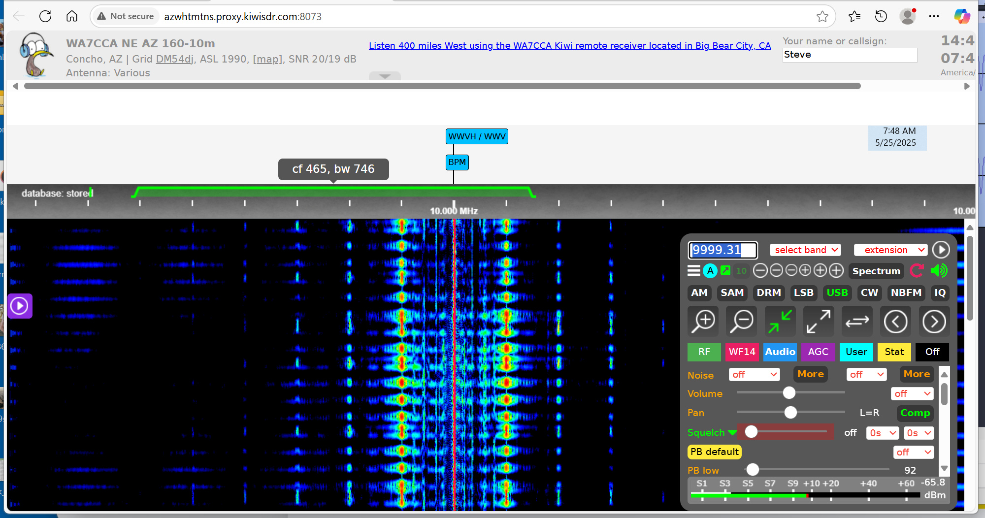

  • I notice you are connecting to your Kiwi via the proxy address. Do you see the same dropouts with a local connection (if possible)
  • Oh. I suppose those are directed at me.
    I had Firefox but hadn't tried it. If Chrome and Edge can't hack it why would I think Firefox would be different. Well golly gee. I just tried with Firefox and it works. No glitches. Strange, but good to know.
    I wasn't aware I was going through proxies. I just clicked on the links in the linkfanel map. I see that some of the links are to proxies. Some are not. They all act the same.
