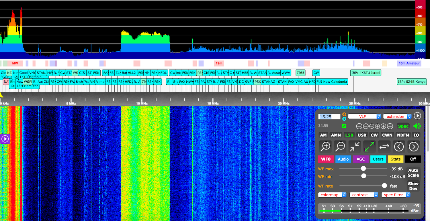

Im located in a urban location with overhead telephone cables with VDLS2 Fiber to the node running ITU G.993.2 profile 17A, wide band noise is at least 20dB above natural floor , reception below 500kHz at nite when RFI is very low I have received NDB 100 watt 2500kms 9-5 receptionm, antenna is a E feild Mini-Whip up 12 mts with 13 mrt RG11 quad sheild coax ground end connected to 1.5m earth rod, Kiwi SDR 20cm from earth rod , ethernet isolator common mode filter, power fed via double insulated linear 8 volt power supply (8 volt mini-whip power feed) 3 amp 5 volt linear regulator power to Kiwi SDR , im assuming have little common mode RFI from my cabling.
The VDSL2 up and down stream bands are very evedent from the waterfall display even the VDSL2 guardband gaps is clearly visible

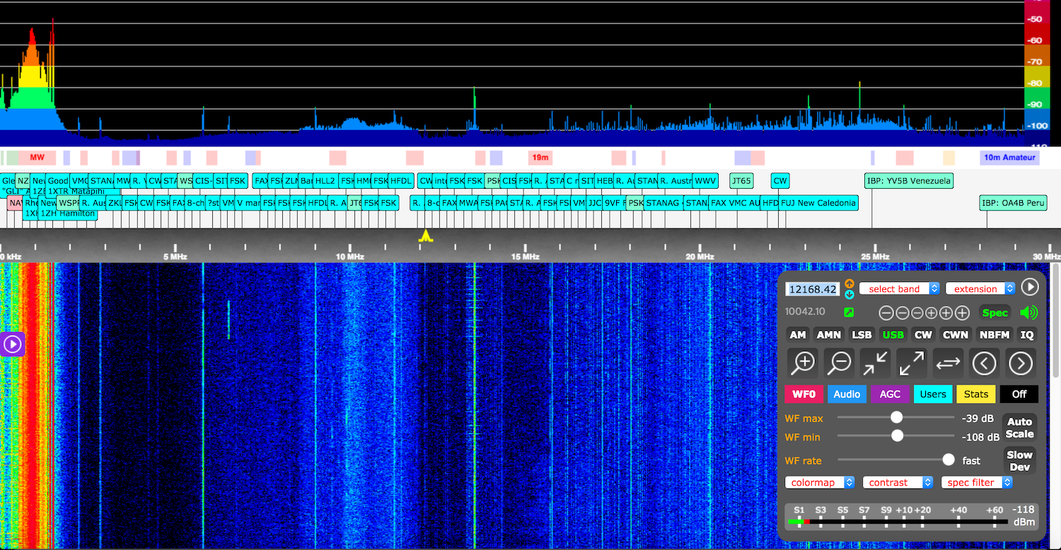

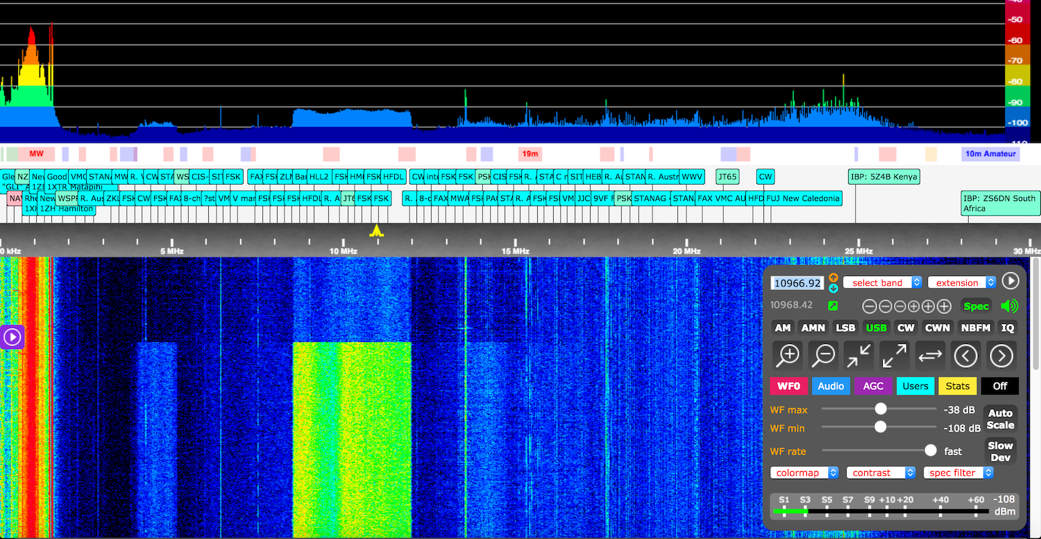

    Before my apartment building was wired for fiber (FTTP) all we had was VDSL2 from a pedestal on the street over the crappy building CAT3 telephone cable. I had some noise, even after adding some toroids, around -95 to -100 dBm (uncalibrated) as shown in the first image. Not too bad.
    One day one of the VDSL band segments jumped up almost 15 dB in signal strength. I looked at the VDSL statistics page on the modem and the "downstream" transmit power from the line card in the pedestal was at +14 dBm compared to the usual +3 dBm, which is what the statistics page said my modem was transmitting in the "upstream" direction. They were always about equal in the past.
    After resetting the modem there was of course a VDSL retrain cycle and the downstream power dropped again to +3 dBm. I happened to catch this on the waterfall in the last image. Not quite as good as what I had before. But a big improvement.

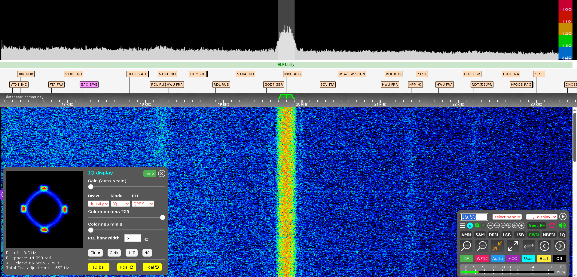

  • Away from VDSL2 noise spectrum picking up VLF NWC 20dB above the noise and very clean eye diagram, interesting monitoting FT8 on 18104 above VDSL2 noise much better than FT8 on 14.074 s/n figures are better on 18Mhz, its seems to me I got a 20dB noise penailty between 2 to 17 Mhz

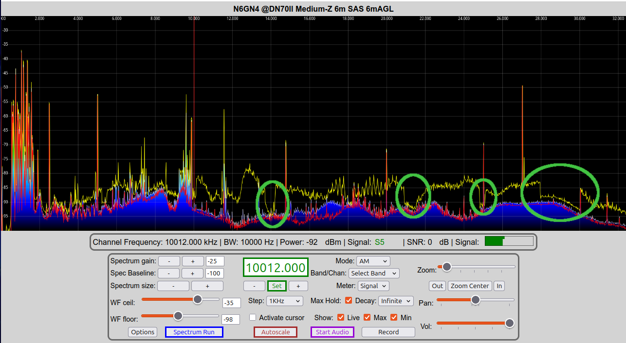

  • If you use a broadband display, particularly one with min/max hold you can appreciate where the QRM is by the ham-band notch depths as well as how much it is hurting your SNR.
    Here is capture of reverse channel, user ==> Internet, Internet-over-coax, QRM leaking from a neighbor of N6GN received on an RX888 and recorded with ka9q-web from ka9q-radio. Some of the ham band notches are IDed. The depth of the notch indicates how badly the SNR is being hurt by this interference.
    This is being received by a 6m dipole SAS which has quite flat field response over these marked frequency range.
    Because of the notches, ham band performance isn't being hurt but SWL and other listening at other frequency certainly is.
