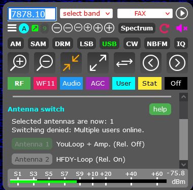

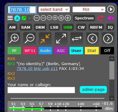

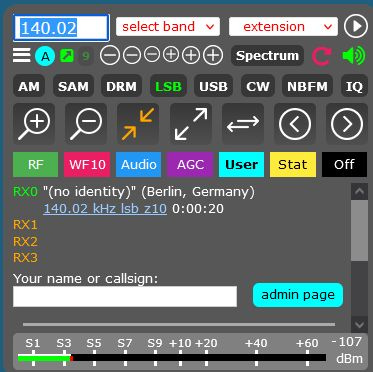

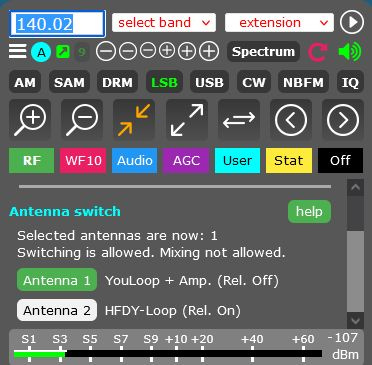

  • Now that my antenna switch is working well, I have noticed one more thing that I wanted to ask if this is correct.
    With 2 users the antenna switch is disabled, that's clear to me so far.
    If one of the two users disconnects and only one user is still connected to the Kiwi, but here as user RX1, then the antenna switch remains disabled.
    Only after the user RX1 is completely disconnected from the Kiwi, i.e. no more users are connected, and reconnects, now as user RX0, is the antenna switch enabled again.
    Is this correct?
    Regards, Steffen
  • No, it's not correct. I've fixed it now for the next release. Thanks
