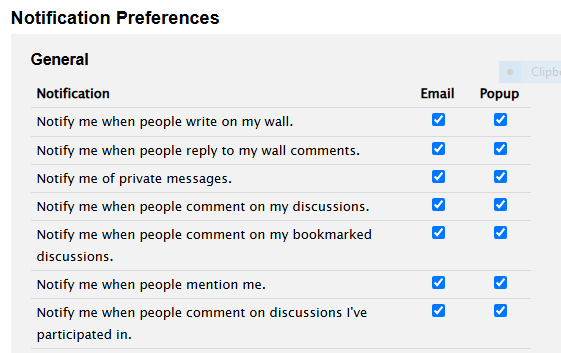

@jks meta-question:
Since I do not have this thread constantly open, I have set e-mail notifications,
but I do not receive notifications via e-mail. What is the problem?
Below are my settings:
